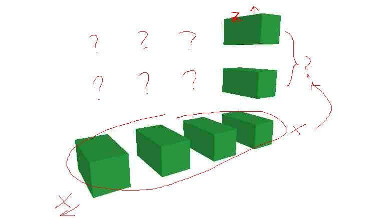

hi everyone i am trying to make an object, and i only need one small code or script part that i don't know how to do, i will post attached an example with smaller (simple) script. This object needs to have sort of multiply or addition option on two axis "x" and "z" with separate spacing on those same axes, so i managed to do it on one axis but when i repeat the script for z axis it only adds (multiplies) my object on the first row.
here is the simple script for a BRICK eg.:
! X axis
for i=1 to NOP
brick 1,2,1
addx psd
next i
! z axis
for i=1 to NOPZ
brick 1,2,1
addZ psdz
next i
this is simple script because the original has objects made from archicad and is too long.
thank you

Hello giza
You need to imbricate the "X script" inside the "Z Script" and delete after each "X script" "nop" translation to return to the "x" origin.
Try this one
for j=1 to nopz
for i=1 to nop
brick 1,2,1
addx psd
next i
del nop
addZ psdz
next j
Hope this helps
