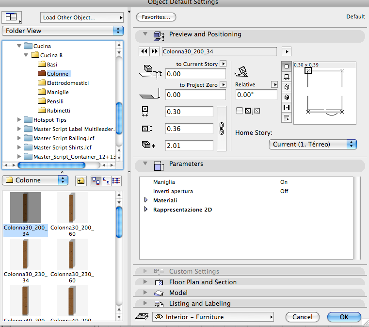

I dl a very nice Kitchen object from Bruno Somaschini.
But I cannot get it to work!
The file is made like the following:
Folder Cucina ---> Folder Cucina B
--->Folder Macro B
I did put the entire folder with the two folders in my Library, ok?
I don't know why the massage keep appearing.
What I did wrong?

It is missing another GDL file called Colonna.gsm.
These GSM files are calling each other and you need all of them for the object to work properly.
Try to obtain it from the source you got this GSM file from.

The collona objects are in the file.
I think you have put the objects in the right place.
If they appear here in the Object Settings Dialog, then they are loaded correctly.
But the object is missing "Colonna", not "Colonna30_200_34" or similar.
I would contact the author with the problem.
I can see his email address in your first screenshot in the title of the panel below the Parameters panel.

Yes, there was a case the Script was not prepared for.
If you select any of the first 4 options for the base of the leftmost element, then the Top of this leftmost element is set to "Colonna", but there is no such element, which gives the error message, but the 3D is good regardless. Only it is annoying.
I slightly modified the 3D Script of the element so now it is working fine.
Find it in the attachment.
