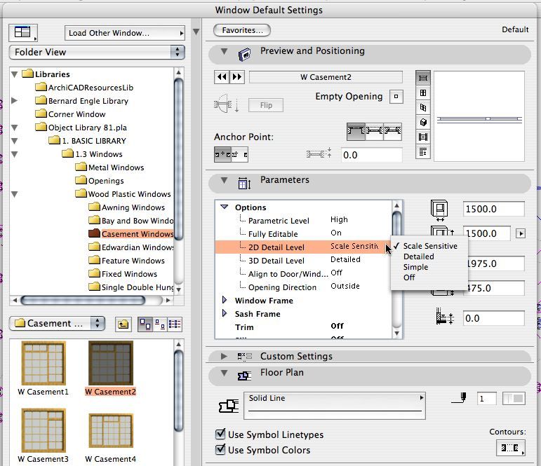

I have a series of windows at 15' above the floor. How do I keep them from showing on the floor plan? Aren't the floor plans supposed to be cut at 4' above finished floor? This same question also applies to small windows above doors -- both of them are shown on the floor plan.

not really 'best practice', but you could always just turn off 2D representation . . .
see attached.
That leaves a big hole in the wall. I checked the display options but couldn't find anything that fixes that. We are probably going to build half the wall on the second story just for the high windows.

Why not just set the line type to "Dashed" in the window settings? This means overriding any special built-in line types and may not look to good if the symbol is too dense, but it works for me in most such cases.

I have dealt with this problem in a simple way by creating
a line type called "Invisible".
It is very easy to make. Duplicate any dashed line type
and make the gap length the maximum allowable and the dash
length the minimum allowable.
This line will have a tiny dot at the beginning and at the end
and one in the middle but otherwise is invisible.
Do as Matthew says and set the line type to Dashed or Invisible
depending on your intent.
The only issue left is filling in the hole in the wall in 2D made
by the window.
If you want to have this all done automatically (make invisible in 2D)
then you have to do what I have done and build this capability into
the library part's 2D script.
BTW this line type comes in handy for all sorts of uses.
