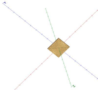

How can I do this cut?
How can I do the cut in the tile's diagonal. I've marked it with a black line on the picture.

In what context? EDIT: Now I see from your other post that you probably mean in GDL.
One option would be:
rotz 45    !or rotz cut_angle for custom cuts
rotx -90
CUTPLANE
del 2
! tile code here
CUTEND
Thank you!
After I put the answer on the forum, and took a break, I suddenly realized another way to do it. I'm working with that option now 🙂
