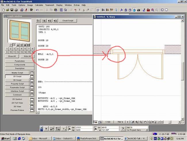

How can I operate mul2 correct?
Please advise
Thank you'
!2D script------------
GOSUB 10
GOSUB 20
MUL2 -A/2,1
GOSUB 20

Hello!
Try 'mul2 -1, 1' and see what happens ...
- Stuart

Thanks for your suggest.
