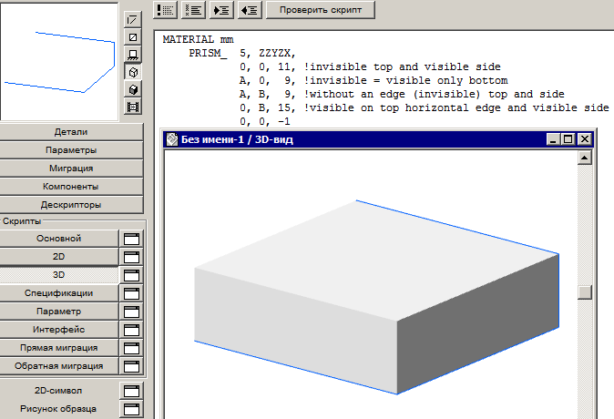

JGoode wrote:STATUS =8 or 9 or 10 or 11 for visible surface.
Hello,
Is there any way hide cprism poly lines for elevations?
thanks
‎2017-07-04 03:00 PM
SL_GDL wrote:I did have a read but I didn't quite understand it and was hoping for a simpler explanation. How do I implement the status codes?JGoode wrote:STATUS =8 or 9 or 10 or 11 for visible surface.
Hello,
thanks
Read about STATUS CODES in GDL Reference Guide
‎2017-07-04 05:11 PM
JGoode wrote:There can not be a simple abstract explanation.
