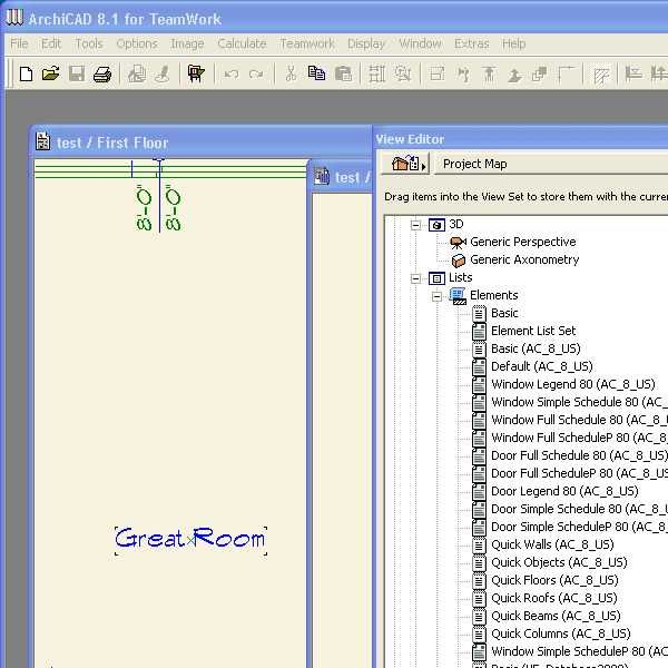

How do I get my I/S office standard window/door etc schedule to show up in the Element section of the List subsection of Project map in Navigator?
Hi Erika,
Alas, you cannot. The List subsection is only for Calculate "list schemes" - which generate information in either a text or graphic window.
I.S. schemes have no window associated with them ... you can either preview the info, or place it on a plan (to be later updated manually).
Yours is one of many ongoing wishes (but perhaps not a poll yet?) for the I.S., so that an I.S. setting scheme could be linked into an LBK and automatically updated, or published (and automatically updated), etc.
If you make a wish/poll, I'll go vote! 😉
Karl
PS To others reading, since a related question comes up from time to time here: there is no means to translate between a calc list scheme and an i.s. settings scheme. They are completely independent.
