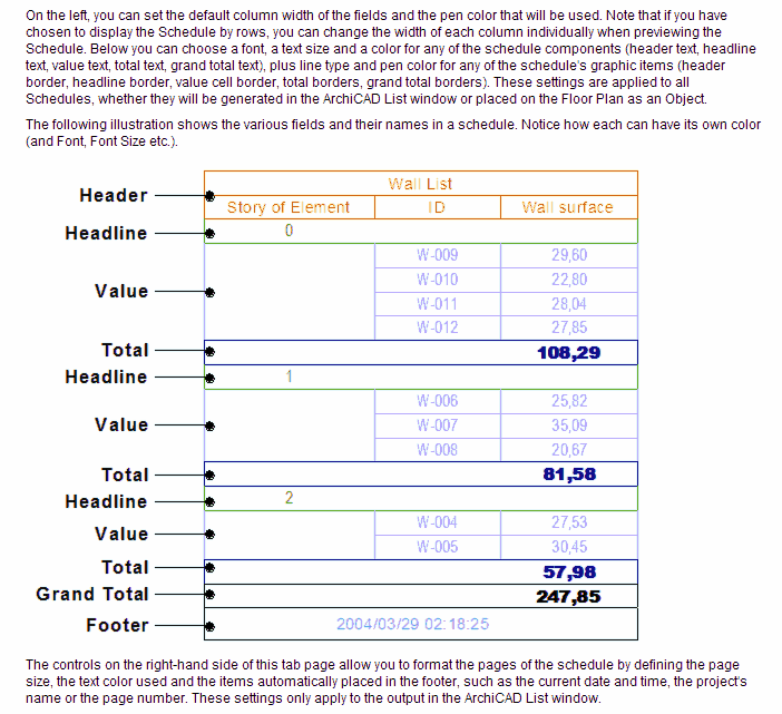

The Preview has only a little to do with the appearance of the placed schedule.
Look at the Format tab for your schedule settings ... screenshot attached ... and change your options there. Note: when you specify text size (height), you also get to specify the height of the box the text is in, so that you can place space above and below the text.

The Format tab is described pretty well in the 9.0 help file, online at:
http://download.graphisoft.com/ftp/publishing/ac9_help/wwhelp/wwhimpl/js/html/wwhelp.htm
for those without 9 yet.
Attached is a screenshot of part of this.
