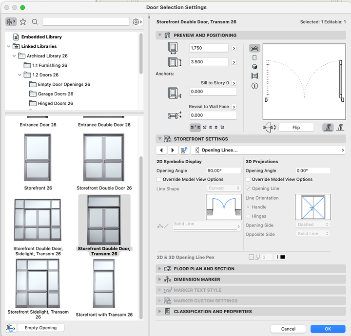

I want to display the door opening line as dotted. However, when I set this in the model view options, one of the two doors in a double door also appears dotted, which I don’t want. Does anyone know how to fix this problem?

I would guess there is a scripting error in the object.
Does changing the level of detail in the Model View Options change anything?
Or override the MVO settings in the object settings and change the line type there?
