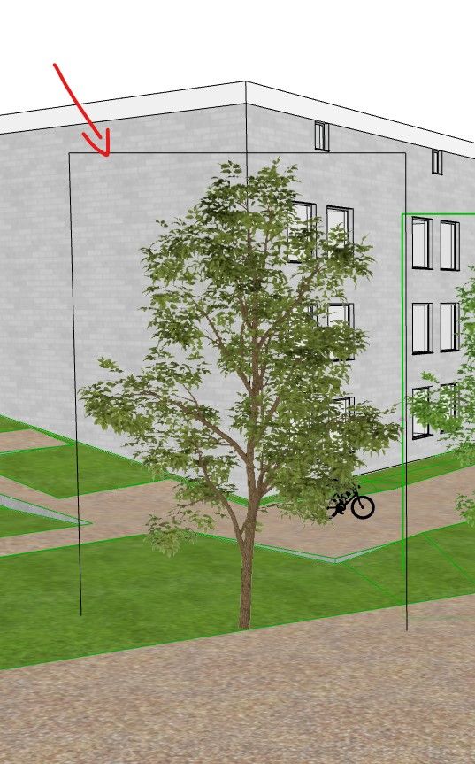

Does anyone know, how to get rid off that frame of the trees in 3D?

Hmooslechner
A veeery good question.. No - You cant get rid of it as far as i know.
thumb Workaround:  Make a new penparameter in the GDL - and give it a light colored pen - then insert this in the 3D-Script (nearly on its end) on this place and save it on a new name - to get a librarypart of You own - without altering the original. Then insert this new librarypart and play with it...

Yves
I think if we want to modify the script 3D of the object then I will do like this
!!!!Old script
!!! edge 1, 2, 0, 0, 0
!!! edge 2, 3, 0, 0, 0
!!! edge 3, 4, 0, 0, 0
!!! edge 4, 1, 0, 0, 0
!!!!New script
edge 1, 2, 0, 0, 1
edge 2, 3, 0, 0, 1
edge 3, 4, 0, 0, 1
edge 4, 1, 0, 0, 1

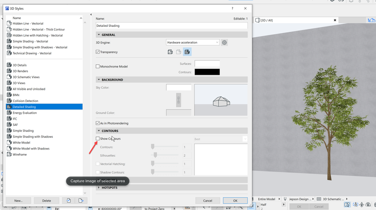

Steve Jepson
Trun off "Show Contours" in 3D Styles.
AEP - Jochen Eggert
Thanks for the numerous answers... have now created an override technique for this tree, and displayed the "contour lines" here!
AC 4.55 -
s2402378
The trees "outline" contour lines are on Pen 4. So - although not ideal - you can retain the contours on the building and reduce the impact of the tree dark rectangle by changing Pen 4 to White or Light Grey.
