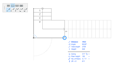

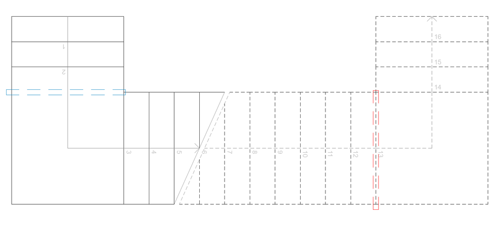

Hi
I would like to remove the red step and have it where I drew the blue rectangle instead. Whatever I do it doesn't let me get that result.
I'd like to avoid weird solutions or splitting the stair in parts.
Thanks a lot for your answer.

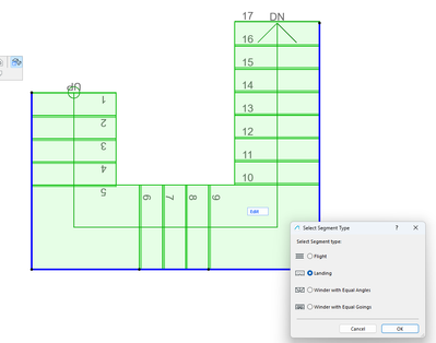

Set your Reference Line to the outside edge, then add some additional nodes for your landings. These extra nodes will define the hard division between your runs and landings. Once placed, you can click on an edge and define it as a Landing. In this way you can force treads to be where you want them to be, rather than depending on AC to figure out where your landings start and stop.
Ling.
ps. You can also define the runs and landings while initially drawing the reference line.
