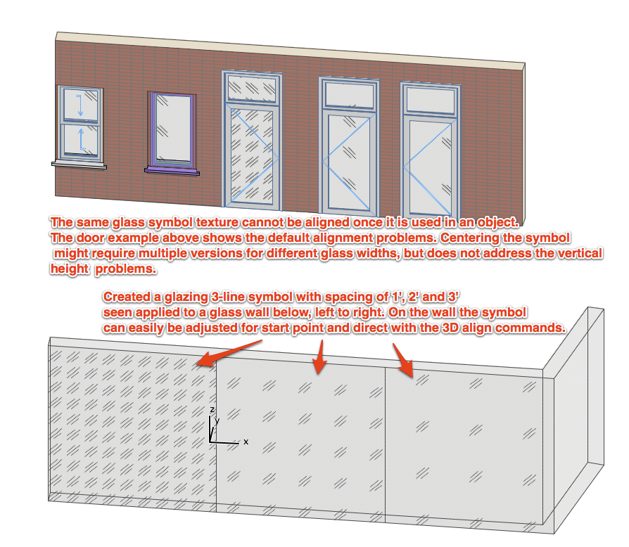

I am experimenting with textures on glazing to be used in windows and doors. On a wall you can align in 3D a texture/fill pattern.
If you try to align that same texture on the glass in a door or window, the command will not work.
I was hoping to have a button in the fill attribute settings to center in the applied instance but, alas, there is yet to be such a choice.
Is there a way to do this, ideally not customizing each door and window?
Similar to door/window opening symbols, I would like to choose which side(s) of the glass it will show on.
Typically the symbol will be:
- centered in the horizontal direction
- default centered in the vertical direction
- able to adjust height vertically to avoid overlapping clutter with d/w markers, ,opening symbols, and everything else we architects always want to have centered.

Have you experimented with the COOR command ?
I think this command is what you are looking for.
Years ago, I was able to control the fill origin of a
material that had a fill assigned to it.
Let us know if this command is what you are looking for.

Hello Erika,
You wrote:
"Are there ways to do this where the solution doesn't result in customizing all the doors and windows?"
Not that I know of, Unfortunately. You will have to modify the
3D script of each door or window.
Thanks,
Peter Devlin

Regrading the doors and windows in the standard library:
The doors are practically one object to modify that is called with different options by the particular doors (but not that simple - see below).
Windows are quite different - there are series of such objects, yet the doors and windows are the most complicated objects in AC library - series of macros called by each other - but the good side is that modifying one of the macros would do the trick.
Best Regards,
Piotr

I made couple of customizations of the windows mostly...
I cannot give You the specific macro that will have the glass right now...(it might be starting with "casement")
The problem is that in such customization - all the macros in line to the one must be changed -You should have to relink to the modified ones for all macros in the "pyramid" going backwards from the last modified one.
