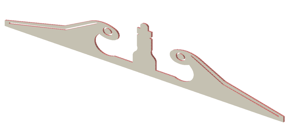

Does anyone know where I can find a rams head pediment 3d object? I have attached a photo of what I need. It doesn't have to be exact.

Sorry, Not much help I know, but
If great "they" would just make it so we could have different end colors for complex profile fills it could be done that way, fILL ON TOP OF FILL on the edge of profiles.
Hopefully someone will come along with better idea soon.
Attached is 4min crude complex profile that, if thought out better and executed with more finesse, might just get you by for now.
For crude shape I highlight the main fill and made other fill on top of it.
That cut a hole the shape of the second fill, kinda like cutting holes in slabs.
Bier

fuzzytnth3
I would model it as follows
Modelling in the plan window as though it was in elevation (this is known as 'slabifying' refer to the GDL Cookbook or Object Making with ArchiCAD book if you have them. You can get the Cookbook here...
www.archicad.ca/?p=84
Use a mixture of walls and slabs for the "Ram Horn" each set at the required height. Once you have one horn done just mirror a copy to create a complete set.
You then select the elements that make up your "Horns" and view them in 3d with an ortho Elevation view, viewing it so that you see a 'Plan" view of the slabs. Save it as a library object. Insert into your model.
The central 'Pot" in the middle can be modelled with the Profiler tool with the base for the pot being modelled with a couple of slabs.
Assemble the Horns and Pot into the correct position and you are done. If you going to slap a lot of these around your Project then I would save the entire assembly as a Library Object, its up to you.
If the horns need to be curved both in elevation and profile then use a Complex Profile instead of Slabs/Walls.
