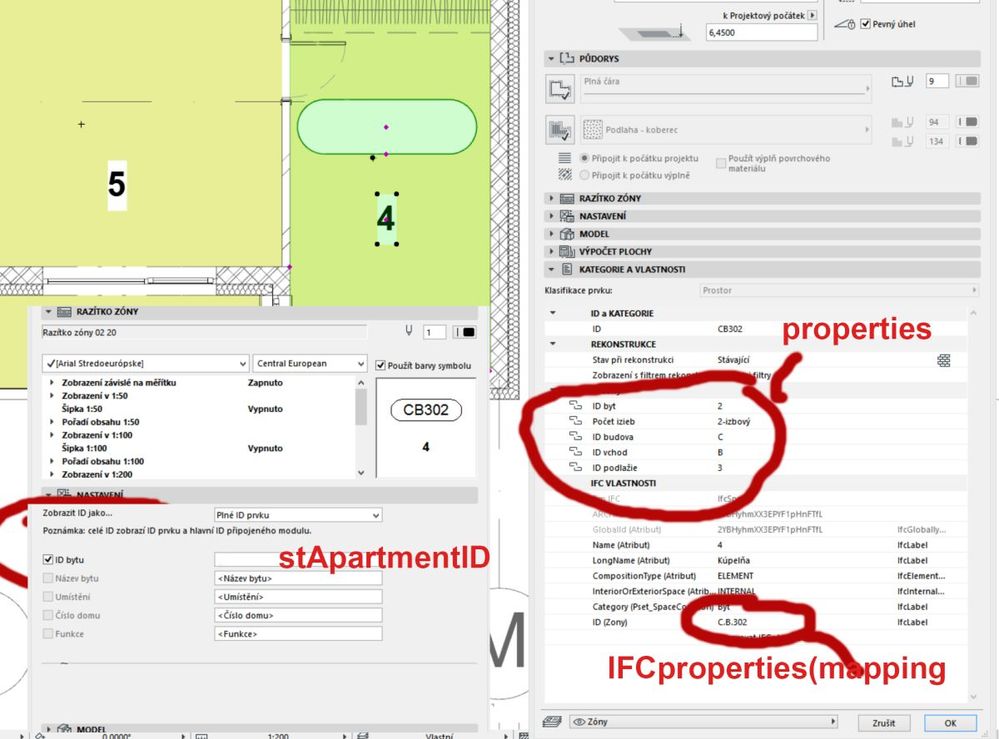

I'm trying to modify zone stamp to automate ApartmentID - stApartmentID = IFCproperties(zome(ID))
I looked at http://gdl.graphisoft.com/reference-guide/request-options
but my gdl skill is not so good and i cant figure it out so I want to ask for help please.

Set the mapping instead IMHO
Piotr
alemanda
Yes Rozky... you have to map your IFC property to get the combined name.
Unfortunately you can combine texts but you cannot make mathematics yet ... we hope in the future

rozky
Thank you for reply.

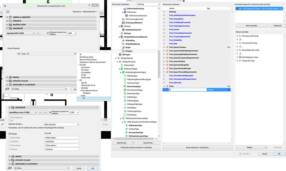

Yes I did it(IFC mapping) problem was to show it in zone stamp.
I finally got it out. I do not know it is clever solution but it work.
This link was very helpful http://gdl.graphisoft.com/tips-and-tricks/display-properties-with-labels
Thank you all

rozky
alemanda wrote:
you have to use labels ... and not the zonestamp
I modify zonestamp. Now it works.
Peter
Ryzen Threadripper 1950X - 64GB RAM; NVidia GTX 1080Ti ; Windows 10 64bit; AC10-AC23 (64bit)
Alemanda: Such requests work in labels, markers and zone stamps without problems.
(I recently modified 21 DW marker to get the fire rating not from object parameter but the properties)
