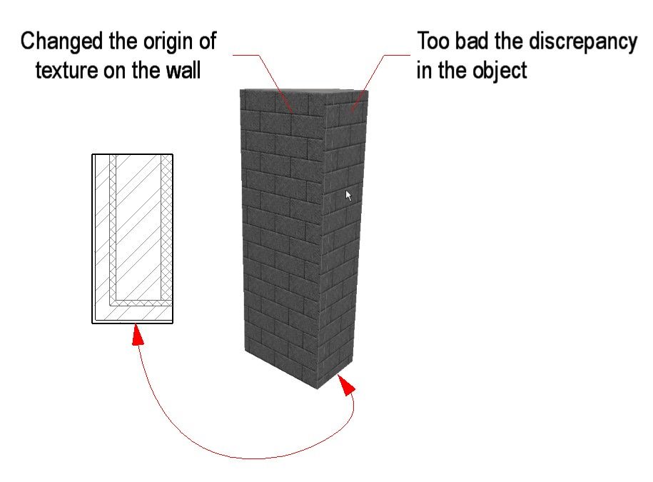

I want to object "Wall End" could know the origin of texture on the wall to which it is attached. Maybe someone knows the necessary parameters for the query?
It turns bad situation. I change the origin of texture on the wall, but at the end of the wall can not be done.

I really can see a way to fix this through GDL... But in your situation, as the textures are the same, you could set the height of the wall end to zero and then the side texture (which you changed the origin) would appear.
Its a work around but it gives you 2d and 3d acceptable results.

Hahaha ...
Good trick! Thank you, Paulo!
3D is fiction.
But still, I would like to solve this in a script (for the future).
3D is fiction.

I'm glad it helped you... But you were lucky with this one simple situation... I guess that in a more complex situation it would be not possible.
Cheers,
Paulo
Valery wrote:Me too! It seems that a new global variable for this parameter should be the solution. I guess we will have to wait for AC15.
