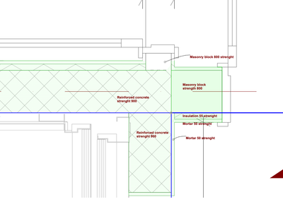

ArchiMind
Typical example of the pointed problem
I also played with junction order, but with no luck

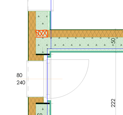

henryL
I have the same problem, the orange hand drawn part should be insulation and not concrete. The only way to solve this is to duplicate materials and give them different priorities, but this really hurts my brain.
Graphisoft should really add the possibility to deactivate automatic connection and let the user to adjust the length of each wall layer (as modifiiers do on complex profiles).

Hi @ArchiMind , I see your case can be solved in Archicad just some fixes, first one of the RC walls should invert it’s reference line then intersect together, second the horizontal  and vertical masonry walls should be adjusted to the outer edge of RC walls, try this it may help.
