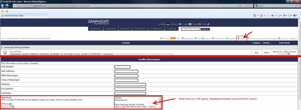

BTW... I noticed that you don't have a signature in your profile... When you get some time, go to your profile section and create one with your hardware specs and AC version... It helps us help you. 😉

Hey Rob... Old dogs can learn new tricks. 😉
If you put your hardware specs, operational system (win/mac) and your ArchiCAD version, people here on the forum can identify more easily what your problem might be.
You are in the right direction...
