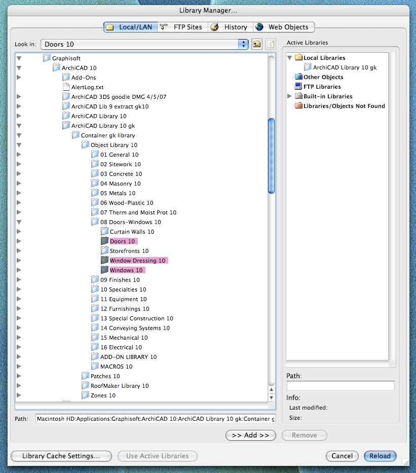

Library object folder visible in L/Manager NOT in Object wdw
Library object folders are visible in the Library Manager but are missing in the Object Settings Window list!
In the Library Manager Local/Lan tab, the "08 Doors-Windows 10" folder has 5 sub folders.
BUT in the "Object Settings" window, only 2 sub folders appear, (when attempting to choose & place an object on the drawing).
See attached jpg file.
The following folders are missing: Doors 10, Window Dressing 10 and Windows 10.
By the way, the same thing happens with other libraries loaded, including the AC9 Lib. The same three folders are missing!
When you view the Library Folder at the Mac finder window level all 5 sub folders including their contents are present.
There is only one Library folder in question on the hard drive.
How do I fix this?

This is the second jpg showing only 2 sub folders

Doors and windows will only show up in the door and window tools! Only a few can be placed as objects, as you've found out in your second image.
Thank you Link
