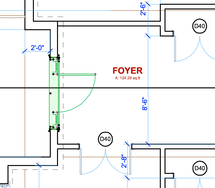

Please see screenshot of the door selected. I am having trouble getting the marker to work for this door object D1 2 Sidelight 17. Does anyone have the same issue? How do I get it to work?

Select another Door the Marker of which is displayed the way you want it and check its settings in the Settings Dialog's Dimension Marker and Marker Settings panels. Then use those same settings on the problematic Door as well. There is really no reason why it shouldn't work on this particular Door type.
Llian
Thanks....There are zillion hidden settings...and I had to go through random check/uncheck exercise and found that it is the Renovation Status that affects the marker to show or hide. Phew...quite a process.
