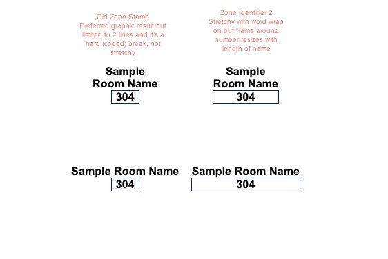

I would like to have the ability to use the word wrap feature for the zone name and resize as needed for the plan, however, I'd like to fix the size of the frame around the zone (room) number, or actually so that the frame around the number would adjust to the size of the text it is containing, independent of the length of the name of the zone. See the attached for clarification.

This is I bit of a hack. At line 226 of the 2D Script of the Zone Identifier 2 14, there is some code that starts:
Then down at line 375 is the code for drawing the text box rectangle:
There is an option for Lines Between Details that I have turned off, it is using the same parameters as the rectangle to draw these lines, so it is not needed if the rectangle contains only one listing.
Now this all gets more complicated if you want to use more text display options, as the rectangle width is determined by the Zone Number, so other text could be longer than this. Also, a similar fix would be needed to show the Lines Between Details.
This should get you started, but as I said is a hack so would need more work depending on the various options you want to enable.
David
max_len = max ( w_roona * name, … w_roovol * volume)That determines the width of the text box rectangle, using the longest of 10 options (for the various information that could be displayed in the text boxes). The one you are interested in is:
w_roonuat line 228, which gives the length of the zone number text (with a bit extra for the width of the rectangle).
if numRow > 1 then rect2 0,-tBlockHeight[1],widthStamp,-vlenYou can modify this code to change the widthStamp (which is the maximum of all text options) to w_roonu which is the <zone number> text length (I think you are using the Zone Number for the Room Number in your illustration, the Room Number is another option in this zone object). So this code:
if numRow > 1 then rect2 widthStamp/2-w_roonu/2,-tBlockHeight[1],widthStamp/2+w_roonu/2,-vlenshould draw the rectangle to fit the Zone Number. (It is a bit convoluted since the rectangle is normally drawn starting at the left edge of the Zone Stamp, but the zone number is shorter than the Zone Name, so I have used 1/2 of widthStamp to get to the center, then added and subtracted 1/2 of w_roonu to draw the rectangle.)
