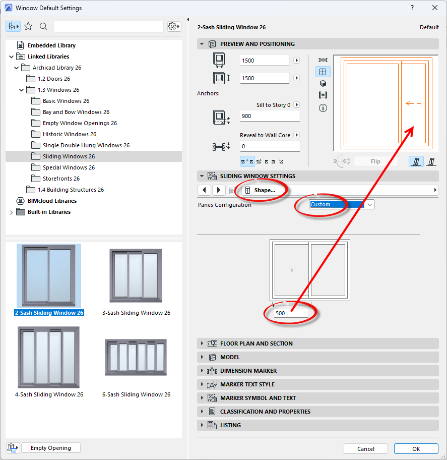

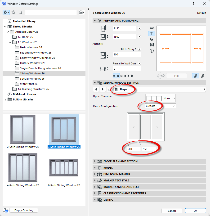

I need to model sliding windows with multiple panes 2 and/or 3 (see screenshots), by default the panes are symmetric, but I need them asymmetric:
The operable pane +/- 1/3 of the opening width and the fixed pane the remaining 2/3 (for the 2 pane window.)
The 2 operable panes left and right +/- 2/7 of the opening width and the fixed pane in the center with the remaining 3/7 (for the 3 pane window.)

That may depend on the language version of Archicad that you are using.
The USA window objects are different to the INT window objects.
This is what I have in the AUS library (I think it is the same as the INT library - not sure though).
Similar can be done for the 3-sash window.
