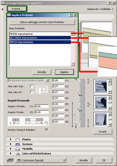

I think there is a better way
Use Preference Button to save and call your settings.
CU mirco
