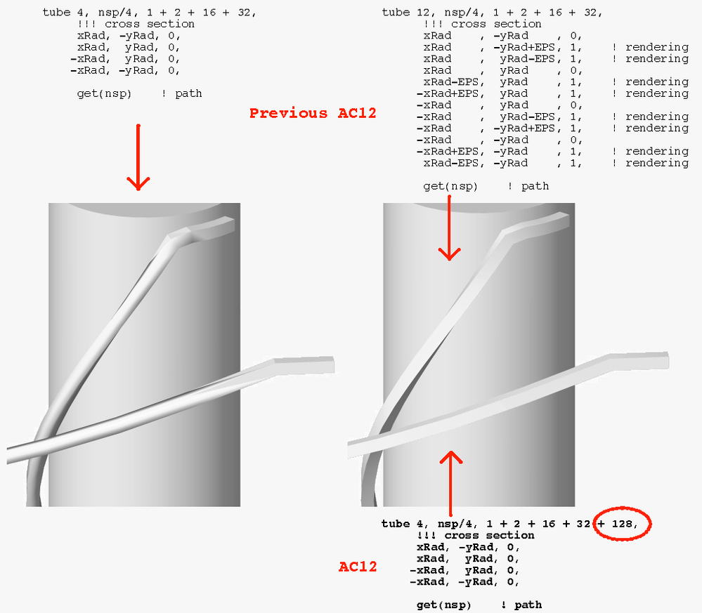

I notice a new status code 128 for TUBE and TUBEA in AC12.
Previous to AC12, in case of a twisted TUBE, you had to script additional points for cross section polygon, to avoid artifacts in rendering.
This, for any cross section with sharp angles (facets).
Since AC12, adding a status code 128, allows to get rid of these additional points.
Great improvement, alas it seems undocumented.
Can someone confirm this.
