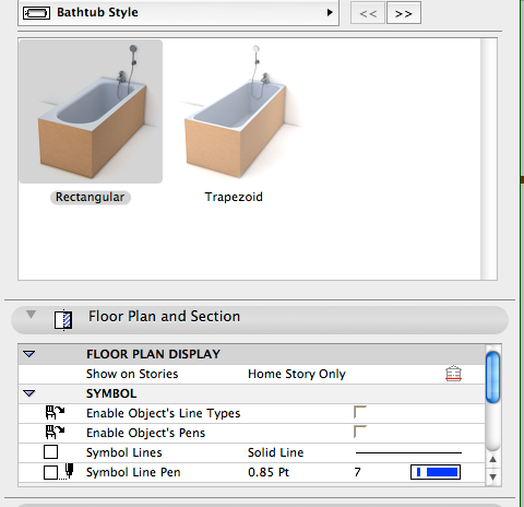

maybe there is a bug for bathtub 17....i have no problem using my pen color for other objects by unchecking the object attribute-boxes but I can't seem to get it work for bathtub 17...I want to show it as blue pen color to be same as the other fixtures but it keeps showing up the default pen color.
Any help on this one?

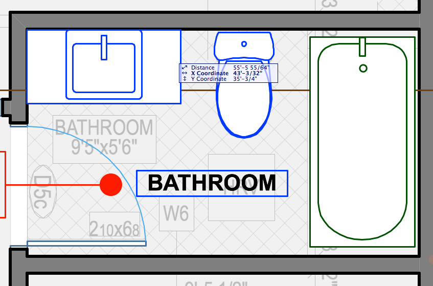

Llian
here's screenshot of the bathroom fixtures...

Llian
You need to check the dnable object line type and ensbke object pens boxes and then any changes you make in the attribute fields of the library part will be used
