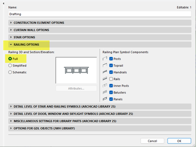

Check your Model View Option settings for railings.
I would say the 3D/elevation settings is not set to "Full".
I've found this option on "Door" settings, but not on "railings" setting
