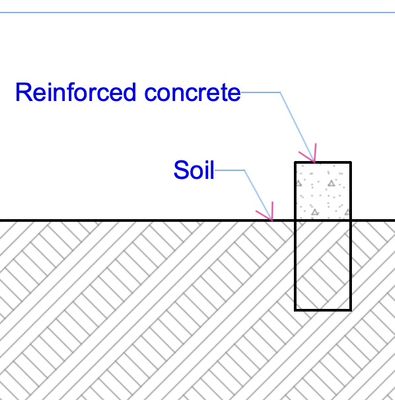

I am not getting this intersection right. Both are with their default material properties.
is there any setting wrong? Please help Thank you

I am assuming that you modeled the "soil" using the Mesh tool.
Unfortunately, the geometry of a Mesh will not intersect automatically with other element types based on the Intersection Priority of its Building Material.
See more details here:
https://help.graphisoft.com/AC/29/INT/index.htm#t=_AC29_Help%2F040_ElementsVB%2F040_ElementsVB-271.h...
You will have to do it manually, using Solid Element Operations (SEO).

Niranarch
Thanks for the clarification.
