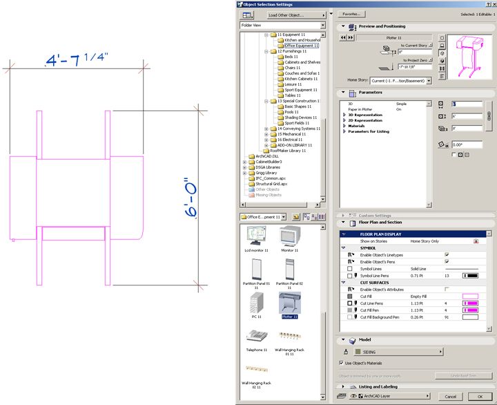

Anyone ever have problems with the Archicad object "plotter 11" where one of the dimensions is always 76% smaller than the inputted dimension? Image is hard to read, object should be 6'X6'. Know of any other objects with similar problems?

This is a bug in the US library part. As best as I can tell from the script, it was probably an international/metric part that was hacked to meet some kind of US dimensions. But, not correctly.
I've posted the corrected version to the GDL Depository - you can download from the 11 Equipment > Office Equipment folder there:
http://archicad-talk.graphisoft.com/object_depository.php?
All that was changed was one line in each of the 2D and 3D scripts.
In the 2D script, the existing mul2 command was replaced with:
mul2 A*0.7722,B/.674
and in the 3D script, the existing mul was replaced with:
mul A*0.7722,B/.674,ZZYZX/1.1
(Only the scale factor affecting "A" was changed.)
