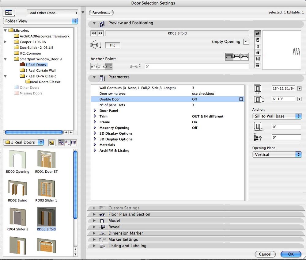

You can do a 3 and 5 segment door opening to one side with smart parts.
Use the RD05 Bifold door
-have "doubld door" set to OFF so all panels are on one side
-choose one of the many door styles or create a custom panel.

If I turn double door OFF, sure all the panels will go to one side, but I can only specify a number of sets, so if I type in 3, I get a six panelled door
Erika Epstein
Kyle,
You need to upgrade your smart parts to version 10.
There are a number of problems using smart parts for AC9 in AC10 and this is just one more instance.
