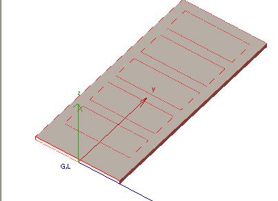

I am writing a script for a multi-panel door. The number of panels can vary. I am able to get all the panels to show up correctly with a FOR NEXT routine, but when I apply this kind of routine to the door panel itself, the holes for the panels are filled in.
This is the script for the door panel
FOR k=1 TO pnlqt !STEP 1
cprism_ intfinmat, extfinmat, sidefinmat,
10, drthk,
-0.5*drwd, 0'-0.0000", 15,
-0.5*drwd, drht, 15,
0.5*drwd, drht, 15,
-0.5*drwd, 0'-0.0000", -1,
-0.5*pwd, brail+(k-1)*irail+(k-1)*pht, 15,
-0.5*pwd, brail+(k-1)*irail+k*pht, 15,
-0.5*pwd, brail+(k-1)*irail+(k-1)*pht, -1
NEXT k
brail,srail, trail and irail are the bottom, side, top and intermediate rails
Can someone help with why the holes don't appear as holes? You can see the pen outlining them.

Erika,
Sometime ago I scripted a door like yours and I realise that to make a "realistic door" (specially in a historical project) you have to make each part separately.
If you build it with one prism you will get only one direction for the door face texture, and I personally don't accept this for a realistic element.
It's because the direction of the wood veins texture is not the same for each part of the door.
So I decided to built it only with PRISM_ and VERT definitions.
It's more simple and more realistic.

Erika Epstein
Olivier & Peter,
I just completed my 5-panel door successfully!
Autoscripted it was 64+ pages(335KB).
The written version is just over 2 pages (13KB)and is fully parametric.
Thank you both very much.
Next I'll try changing it to separate rails and stiles per Paolo's comments.

Erika Epstein
Yes,
They are sprisms for now. I'm waiting for the measurements of the actual ones, so I can extrude or bend(?) around the opening.Both sides of the door.
I also need to:
-add in also a scale dependent resol so that at 1/4"the linework doesn't turn into a blob.
-add in the single pane glass panels. Some are 2panels +intermediate rails high, others are 3pnls + int. rails high, etc...
