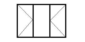

I cant seem to find a window that has two side-hung windows (one on each side) and a whole fixed window in the middle.

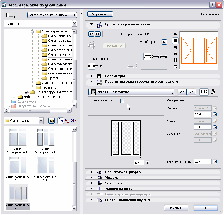

Look for this window (see picture). Remove it transom.

But how do you put in a transom (or split) that devides the two opening windows. but not through the middel one?
If you know what i mean.

Like this..
You can create a custom window panel if you cannot find what you need in AC Library.
Simply make your window panel from slabs; then go to File > Libraries and Objects > Save Custom Component. Choose "Custom Window Panel".
After this, choose a window, go to its settings > Sash - Individual Options, choose "Custom Panel" and the newly created panel should be available there (in "Custom Panel Name" field).
For more info, you can do a search for "custom components" in AC Help.
Cheers.

dD3 wrote:
Like this..
No sample on the basis of which it can be done. Even if you use "Custom Component". You should make its own window.
Then how can i do this?
In this case you can create a custom window. Make it from slabs and save the 3D model as a window (see attached image).
