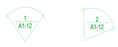

I'm looking for a photo marker/ object to indicate where a photo was taken with camera location & direction plus drawing sheet/ detail number. The photo is on a separate sheet of numbered photos. Has anyone found a label/ marker / object like this? Example attached.

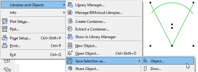

The way I would do it without GDL knowledge would be a sort of rough but functional workflow:
Draw the angled lines and the arc. Select it all and create a 2d symbol object: File> Libraries and Objects> Save Selection as...> Object...
Place the pictures in a different worksheet view each, so they can be placed as drawings in a layout.
Create a Worsheet Marker referenced to The selected drawing. Browse for it.
Use Worksheet Marker 01 27; set the Marker Head as None or Line and choose the Show Drawing ID and Show Layout ID options for Marker Text.
Save it as a New Favorite for future use.
Now you can place the marker and the 2d symbol together. The symbol can be rotated and grouped with the marker if you need it.
I'm sure someone with better GDL programming skills could come up with a better solution, but meanwhile...
