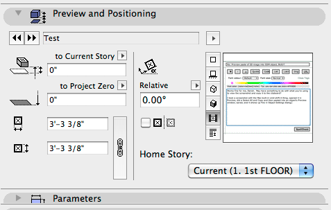

I thought maybe it was because my screenshot was smaller than the allowed pixels... so took a screenshot of this message composition screen - and it was properly reduced upon paste, see attached.

Thanks Karl, On attached you see that the preview shows up in the GSM object window. Saved it and in Archicad library object selection pane there is no preview (bottom left corner). I am puzzled.
Daniel
