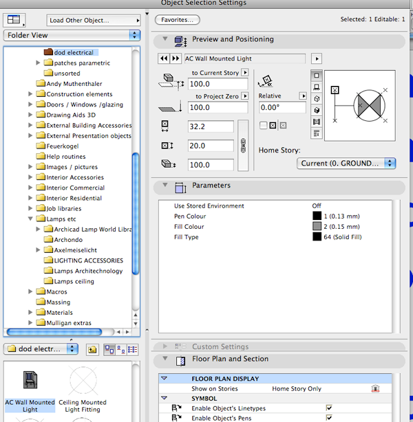

Thanks Karl, On attached you see that the preview shows up in the GSM object window. Saved it and in Archicad library object selection pane there is no preview (bottom left corner). I am puzzled.
Daniel

Karl,
Had a problem uploading second image.
Here it is.
On opening the object , no preview shows up for the wall lamp symbol.
See left bottom of screenshot, object highlighted.
Screenshot was made same as you did.
Daniel

Strange. Tried again and works perfectly for me, both embedded library and linked lib. I notice in your screenshot of the Object Settings dialog that you are looking at the symbol image. Is the preview image showing up properly there if you click that button, so that it is only the icon which is not showing the preview?

Hi Karl,
No nothing shows up there either. I sent the object tot a friend of mine in Austria and it did not work for him either. It always worked for me but not in AC13, pasting from a 3D rendering image from the objects 3D window is no problem. Just the 2D screenshot. I tried jpg, tiff, png etc, nothing works.
