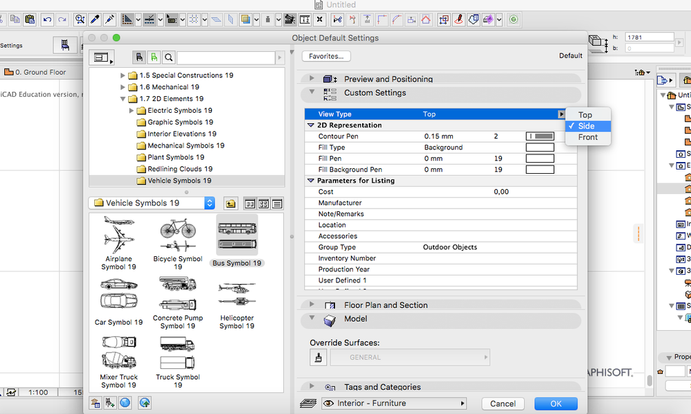

I have a problem about custom settings, 2d archicad library Archicad 19 . I select an object choose another view but it doesn't change. Like I choose side view, but it is still top view !!!. It happens with people vehicles, etc. I send an image.
Anyone solved this problem ?

Are you on El Capitan? That may be the cause of the problem:
http://helpcenter.graphisoft.com/technotes/operating-systems/mac-os-x-10-11-el-capitan-beta/#Can8217...
You will need to install update 4011:
http://www.graphisoft.com/downloads/archicad/updates/AC19/AC19-3003to4011-ReleaseNotes.html
Update 4011 also introduced some other issues, so after that you will need to install update 4013:
http://www.graphisoft.com/downloads/archicad/updates/AC19/AC19-4011to4013-ReleaseNotes.html

Thanks!
I'm going to try it !
