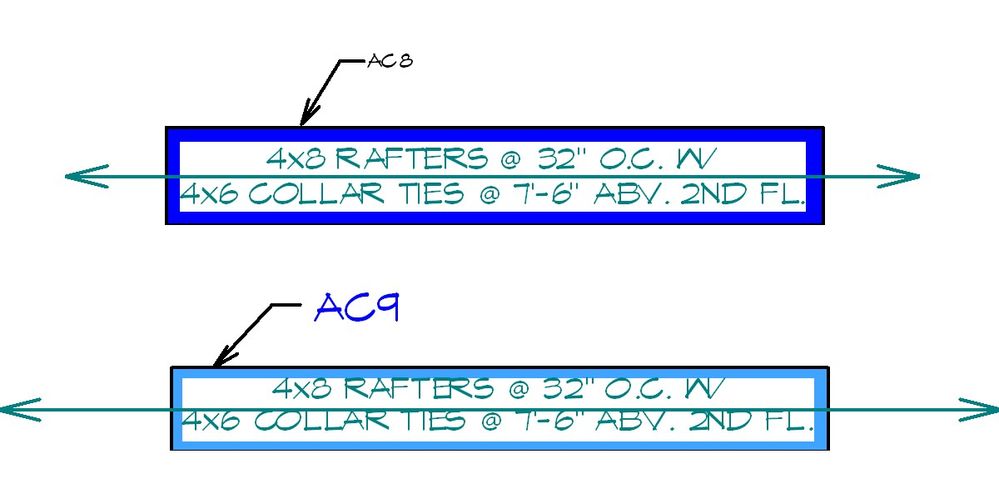

Problem with text
What would cause text to shift upward in the same object when it was brought into AC9 from AC8? (SEE ATTACHED PICTURE)

Does this text always set kind of high in its bounding box?
This is a known bug with the text leading (the space between lines of text.) We had a similar problem with a font we use.
Yes in 9 it does, but we never had a problem before 9.

Does anyone know if the known bug is being fixed?
Also the font I'm using is "Architxt". Is anyone else using that font having the same problem?

Hi Red,
I haven't seen bug or problem.
try this :
offset = 5
HFont = 10
DEFINE STYLE "mirco1" "ARCHITXT", HFont, 8,0
DEFINE STYLE "mirco2" "ARCHITXT", HFont, 2,0
i = REQUEST ("Height_of_style", "mirco1",alt_ezza)
alt_ezza = alt_ezza/1000*A_
style "mirco1"
stringa1 = "I haven't seen"
stringa2 = "problems"
lung_1 = STW (stringa1)
lung_2 = STW (stringa2)
tot_lung1=(MAX(lung_1,lung_2)+offset)/1000*A_
tot_lung2=(MAX(lung_1,lung_2)+offset*10)/1000*A_
rect2 -tot_lung1/2,-alt_ezza,tot_lung1/2,alt_ezza
line2 -tot_lung2/2,0,tot_lung2/2,0
TEXT2 0,0,stringa1
style "mirco2"
TEXT2 0,0,stringa2
CU mirco

A bug that may cause it is fixed in the latest (build2018) hotfix. Update to see if it clears the problem.
Greg
Gergely Kmethy
VP, Customer Success, Graphisoft
