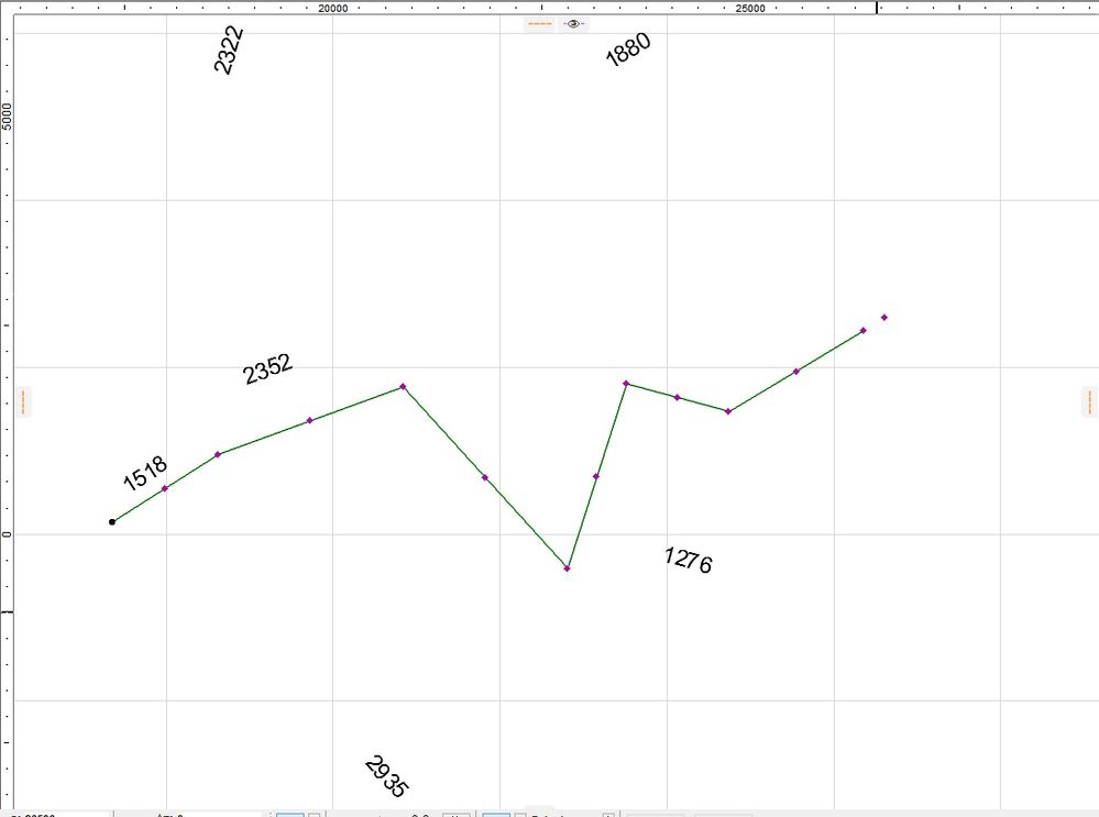

I have problem with rotate text on line2.
When I put to script ROT2 alfa, so text (line size) put away from line and I dont know, why do that and How to fix it. Alfa is allright and insertXHotspot, too - I checked it computationally and manually.
Can you help me?

At a quick glance it is your DEL i+1.
For the first line segment you will be deleting 2 transformations (1+1), for the second line segment you will be deleting 3 transformations (2+1), for the third 4 transformations (3+1), etc.
But you are only performing 2 transformations for each segment (ROT2 and ADD2)
Try just DEL 2.
sinceV6
Hi.
Also, if this is for the polyline script I made, you should place ROT2 command after the ADD2 command: if you rotate first you are not moving in the right direction.
You first move to the current point in the array (add2), then you rotate the coordinate system (rot2), then you place your text, then you delete these transformations (del 2) to start the next iteration.
