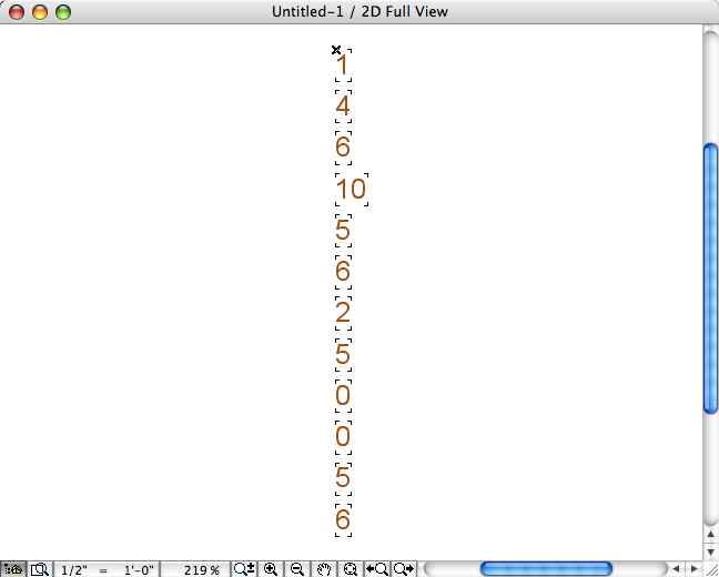

I just tried the RND function and it seems to be working as expected:
Define style text_style `Arial`, 3, 1, 0
Style text_style
FOR i = 1 TO 12
Text2 0, 0, INT(RND(12))
add2 0, -0.006*GLOB_SCALE
NEXT i
This produced the attached...
A fairly typical random sequence between 0 and 12.

Thanks for trying that. I took your script and tried it as an object and what I found was that it does generate random numbers but if you insert the object again it produces exactly the same numbers.
What I did find was that when you close and open the drawing again all the numbers change but all the instances of the object still display the same numbers.
So to get the random People in my object to work I would have to insert one instance of the object but have a number of random People appear like your script and I suppose I could also place each Person in a random position similar to Joachim's object. Sounds like this would be an even easier way put some People in my drawing
