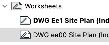

Eduardo Rolon
Looks like I misread something:
If you want the list to go:
AR1
AR11
AR2
Then you need to add "0"s  to separate the areas.
This is not correctly alphabetized. The Bug I am referencing is that AC use capitalization as part of the sort.

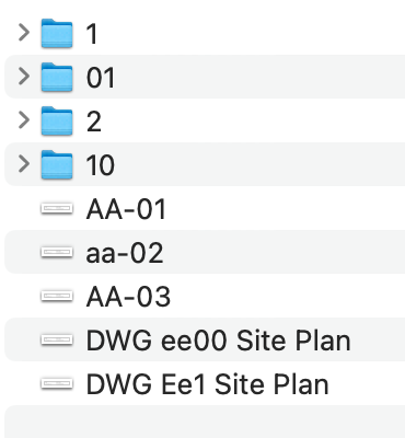

Eduardo Rolon
The OS does it correctly
