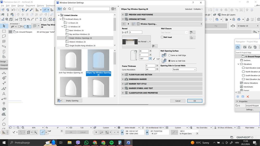

Hi everyone,
can someone help me change or deactivate this rule? Picture in attach.
Thank you so much

I do not recommend it but it is possible.  (I suggest making  a custom windowopening :  https://help.graphisoft.com/AC/26/INT/_AC26_Help/040_ElementsVB/040_ElementsVB-294.htm )
Removing the rule:
Open the object (ctrl-shift-o), and in the parameter scrip add "!" in line 35 >> Values "openingArchHeight"

Thank you so much, it worked. But I have to ask why you don't recommend it and can I use this for all object with that rule?
Thank you once again!
