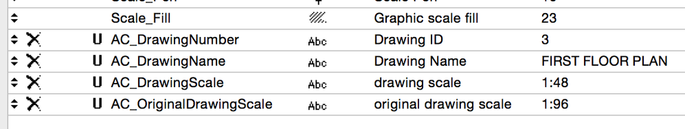

David Maudlin
Rockstar
Derek:
I am not sure what is the cause of your issue. My title library part is of the Sub-Type Drawing Title, and has the parameter AC_DrawingScale as a Text Type parameter (see screen shot below). All the references to AC_DrawingScale are shown in my previous post, there is nothing else done to this parameter. You could also look at a Graphisoft title to see if there is something there (or not there) compared to your code.
David

derekjackson
How odd - loading up the Drawing Title subtype doesn't offer me that parameter, and I can't seem to find it in other Graphisoft objects or other nearby subtypes.
This page suggests it should be there:
gdl.graphisoft.com/gdl-docs/gdl-guide/chapter-12-miscellaneous/fix-named-optional-parameters/paramet...
but the attached is what I see when I start a new object with that subtype - not sure what is going on here!!
