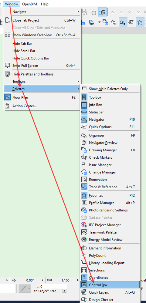

When placing objects, walls etc around I often type in the distance from a point and then + or - depending on how far or futher away the point I want my thing to be. Pretty common I guess... but if I want to place something just halv-way there is no /2 command? Yes, I know about snap points but if there is no such help to get when placing things in open areas this wont help me.
Does anyone know if there is such a command?
1 ACCEPTED SOLUTION
Solution
There is a 'relative construction' tool that will allow you to place an object or start drawing an element halfway along the distance you choose.
I am not sure of the tools name, I just call it the halfway tool.
I am not sure if it is in a standard menu or toolbar, as I have a custom setup I have used for years.
But you will find it in the 'Control Box' palette.

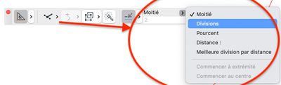

 Hi, to be more precise it's much more than a "halfway" tool as it works in conjonction with the division settings on the same palette. 

Divisions is set to 3 and will not work for half-way solutions, but Barrys half-way tool or "Snap Point Constraint" as it is called did work out fine. I set the tool as a keybord shortcut (chose H for half-way) and after Ctrl+D command clicked H and started to draw the line.

I was just specifying that the tool can do much more than just the half. The division can be set from 2 to 99 in the box below Half and you can also use percentage and repartition. For sure for a half you can let the setting on half.
