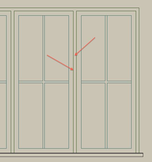

Decided to use the ribbon triple window for a bay, any way to adjust the thickness of the mulls between the windows???
Attached a pic with arrows showing where I want to be able to make thicker or more thin.

I don't think you can, I looked at all the parameters... it stays at 1 1/2"
Well that stinks. If I gang them together they don't fit together right, if I use ribbon I cant adjust mulls. Whatever happened to the ganging option in AC11 or 12? I remember it worked like a charm and never had any issues.

Not all windows are created equal. But many have the 'vertical spacing' option for that very purpose. Look under the Parameters...

Which window are you using? I was needing a double casement with a mull between. The ones on AC offered don't have a mull between.
Here's a casement with a mull....
BTW you can disable the transom under 'shape and opening'.
(Works the same in AC16)
PERFECT! I didn't know you could cut off the transom in that window. It's exactly what I needed.
