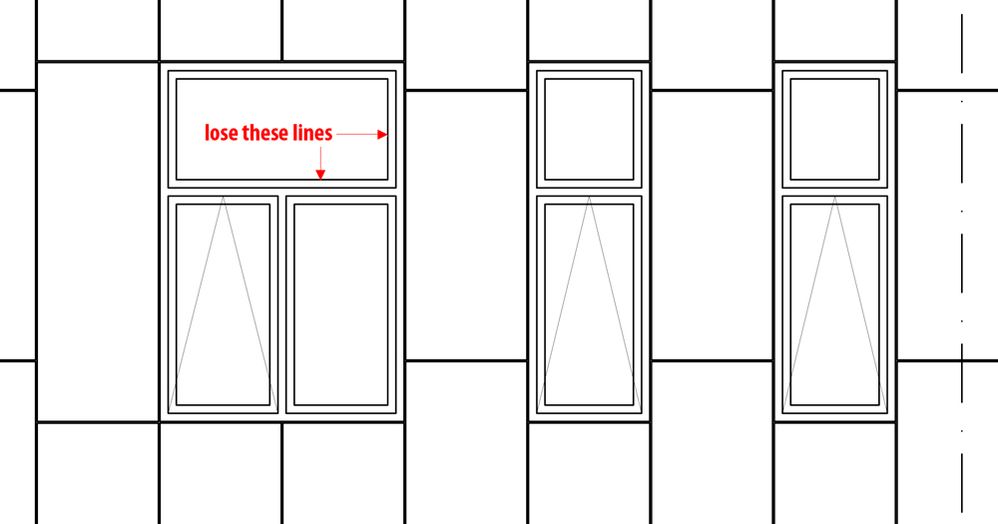

Hello, I wonder if anyone can help me? I'm working on a project with two fixed windows and one openable window which I made through the Fixed Casement Combi Window. The problem I have is that the 2 fixed windows have additional sash frames around them that would not be there in reality as shown in the attachment. Is there anyway that I can lose these from the model of the window?
I much appreciate any help that can be provided
You could try using the Modular Joinery object. It allows any arrangement of doors, windows, and panels to be arranged within a single opening, and the action of each door/window can be described independently in detail. The attached image shows an example similar to your request.
