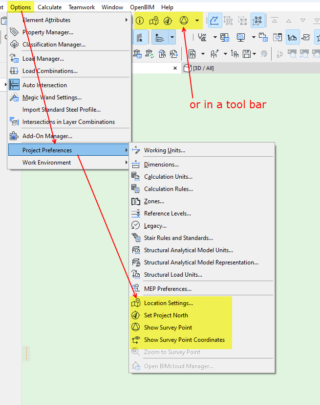

Yes, I've noticed that. I am curious though if it's possible in AC to simply drop in (xref) georeferenced files with respect to the origin, place a hotspot where the origin was, and then move the origin closer to the georeferenced file? Then, when the surveyor needs to go and stake out the building etc, move the origin back to its original position so they have the correct georeferenced coordinates for staking out in the dwg file. Would that work? Just curious how to retain the very valuable georeferenced coordinates within AC without causing issues due to large distances away from the project origin?..
Lingwisyer
Guru
Use the Survey Point to offset it.
I am no expert on this as I don't use it.
But you need to keep the model close to the origin as Ling has suggested.
There is a 'Survey Point' that you can place where the survey should be that will allow for geolocation when you share files with other software.
But as I mentioned, I really don't know how this all works as I never use it.
Mik001
Tell me if I have this right. After dropping in the georeferenced xref files so they stack correctly, I then move the entire project somewhere near the project origin. Then I activate the survey point, at which stage I need the Easting and Northing values (from the surveyor I'm guessing) to input into the coordinates box. When I save out or export the file, I use export with survey point and not with the project origin. Is that correct?
I'm just quite confused as to how the drawing remains correctly georeferenced after the project is moved closer to the project origin.
Please forgive these basic questions, I have not used the survey point for georeferenced files before.
Lingwisyer
Guru
I have never used it in AC either, but yeah, export by survey point. I assume it remains correctly georeferenced as the coordinate you put into the survey point offsets the distance to project origin. That is what is suppose to do anyway.
