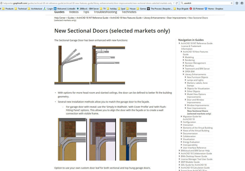

I've recently been contacted by Graphisoft UK to discuss how they can improve their UAS (or SSA??) subscription service. All very positive.
During talks we discuss desired objects and I remembered an article for new enhanced sectional doors for AC18. See image attached.
Has anybody see these??? I installed INT, USA and UKI versions and none had these much desired (and needed) doors. Wondering where the selected markets are.

No that is the version 17 door.
There is a 'new and improved' one in 18 but it is only available in "certain markets".
AUS (where I am) is not one of them.
It seems INT, USA and UKI are not one of the markets either.
The answer it seems is that it was for germany only.
UK graphisoft have asked HQ if it can be put into UKI/ INT markets.
Confidence in user influence over developer is increasing!!
