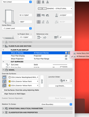

Hi - can anyone help me out with this? The door is on the lower level, and I need it to show on the 1st floor level floorplan as well. Thanks!

You can make the door appear if you make the wall consisting of the door appear above via show on stories option in floor plan and section panel.

Appreciate this. Now how do you get the wall to show? The door and wall are on the -1. lower level, but I need them to show on the next level up. It doesn't seem to be giving the option to change this?

Adjust wall height to exceed to the next story & go to the upper view & from view settings - set floor plan cut plane to show down to 1 story below,
Please Note that FPCP settings will affect all view elements.
