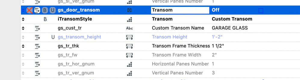

Thank you for this is it helpful. When I went into the object master I did not see what you have sent an image of. I then went into the parameters tab and tried to turn on the transom option in there and it would not let me click it. Any ideas what I might be missing?

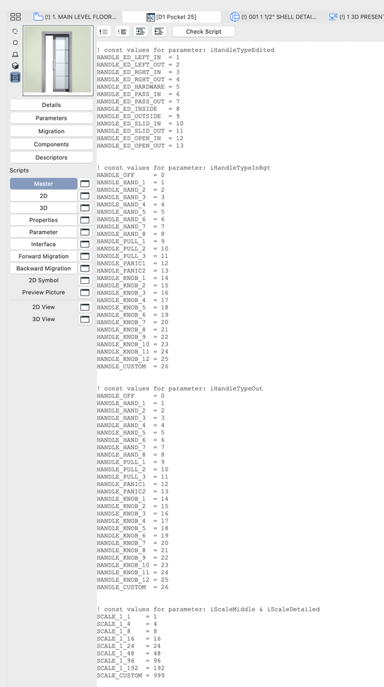

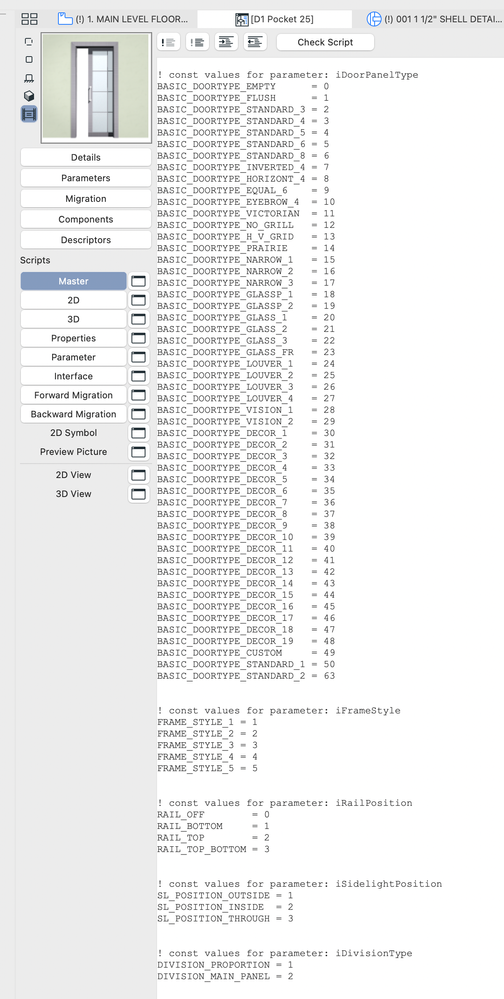

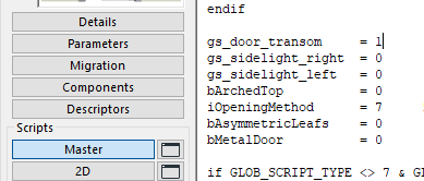

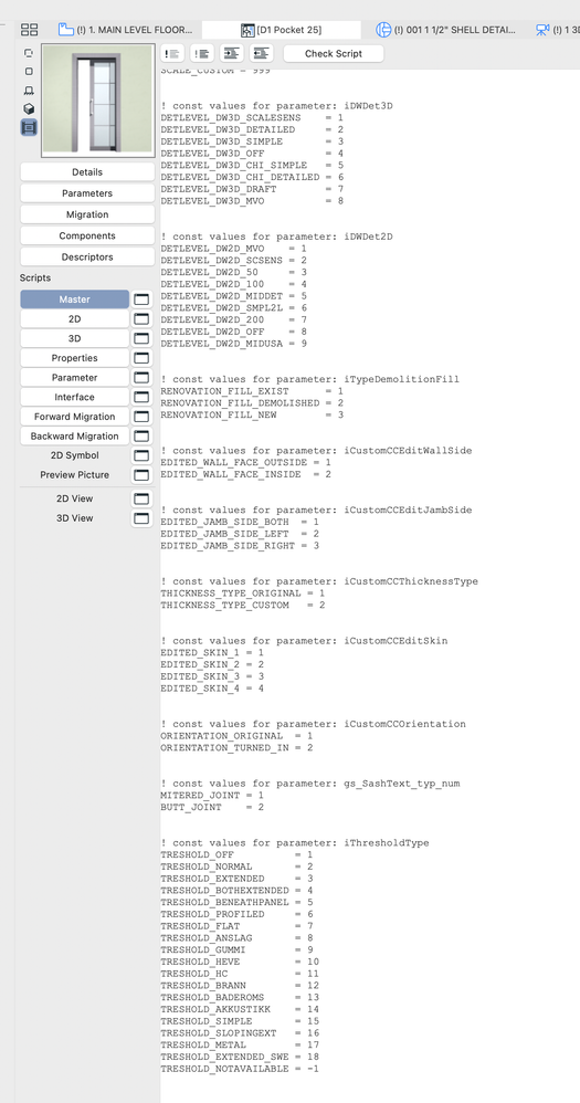

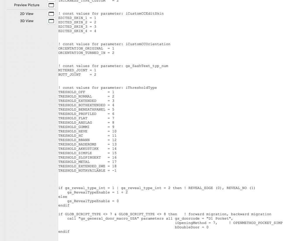

Given the display units, do you happen to use the US library? That might be the cause for the difference. Please add a signature to your profile with the relevant information as stated on the link in mine. So what is in the Master script?
KDEE
I am using the US library. Ill attach images of everything that is listed in my Master script.
Screenshot 2023-01-13 at 9.55.40 AM.pngScreenshot 2023-01-13 at 9.55.27 AM.pngScreenshot 2023-01-13 at 9.55.32 AM.pngScreenshot 2023-01-13 at 9.55.21 AM.pngScreenshot 2023-01-13 at 9.55.11 AM.png
Lingwisyer
Guru
Yeah... US library things... Might you be able to make do with downloading the INT door from BIM Components? This can be done through the door tools search bar. "Pocket Door [version]"
