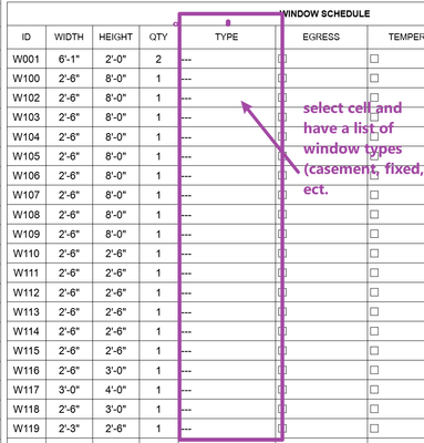

Is there a way to add a column in your window schedule that shows opening types (i.e. casement, double hung, fixed, ect.). I would like to have the ability to go into the cell and have a list of all available window options (i.e. casement, double hund, fixed, ext)? and select a type and have it show in the cell.
Also can you add as many custom opening types as you want (i.e. double casement, transom over casement, ect).
Thanks

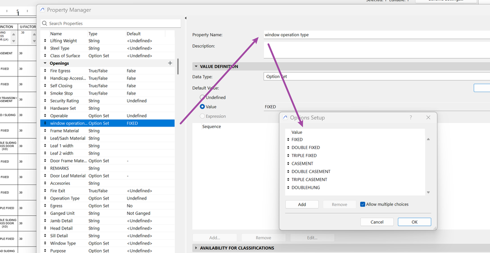

If you want a dropdown for custom opening types, you can easily set it up with a custom property, set the data type to "Option Set".
Press the "Option setup" button you can enter the different values you want.
Then make sure you allow the window classification to access that property.
After that you should be able to schedule your new property.
See below for how to set up a new property:
https://help.graphisoft.com/AC/29/INT/index.htm#t=_AC29_Help%2F045_PropertiesClassifications%2F045_P...

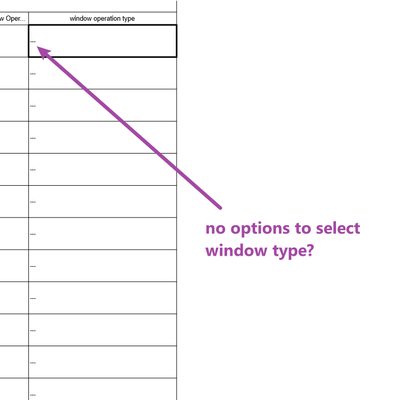

Hello, I set up as you indicated but am still having issues of not being able to select the window type? What am I missing? Thank you
a month ago
Never mind, Forgot to select the classification in the property manager. Thanks again
