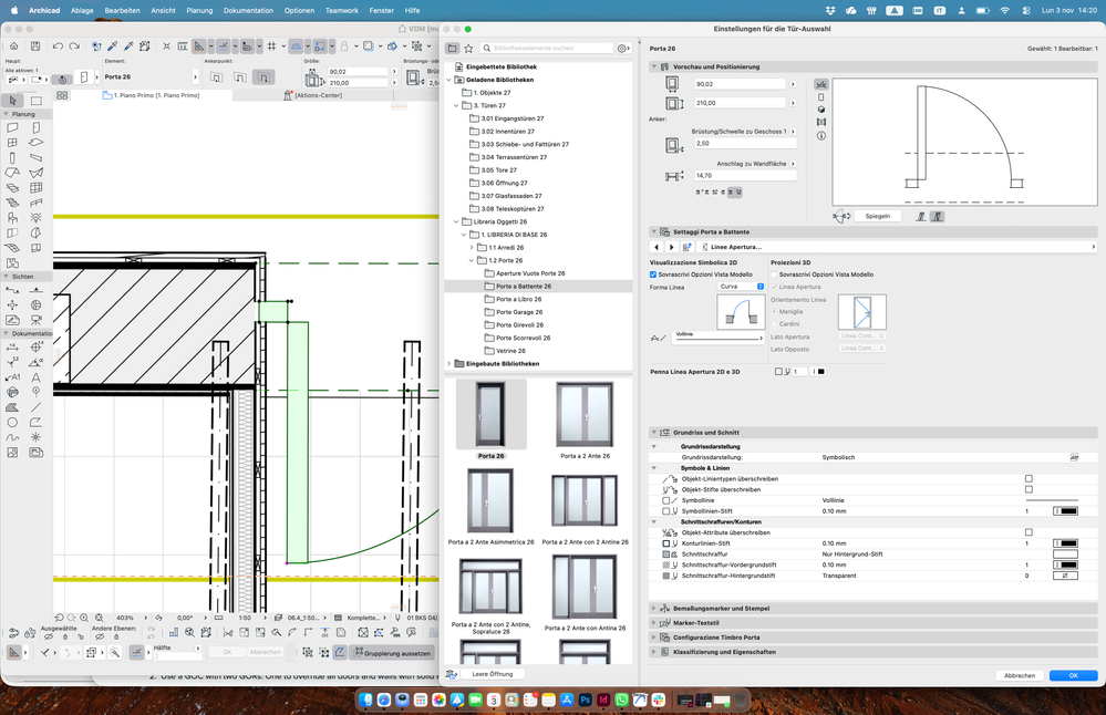

hi all,
as shown in the image, the sides of the door should be with the same thick pen of the sides of the walls (it should eventually turn around). I'm not using a composite wall because it is not a straight one.
All the pens of the door do not suit the necessary solution.
Would you please let me know where I'm wrong?
Thank you!
Solved! Go to Solution.
2025-11-05 11:27 PM
Just a guess: Is Ganging turned on for that side of the Door?
2025-11-05 11:27 PM
2025-11-13 10:54 AM
Hi Laszlo, thank you for your answer. It was indeed that almost hidden setting!
