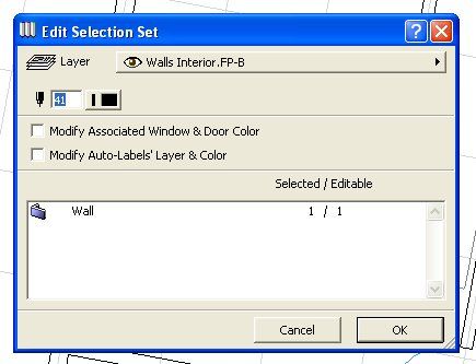

Daniel,
we call it the communism tool, just look for the hammer and sickle and it brings everything to one.....
and it will lead you to this box....
the communisit command, rofl... thats great
